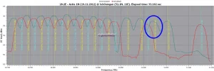

actual no signal on 11023H for me. Thats the result of a scan from 10964H, 10994H, 11023H and 11053H
here again the scan result from 19.11.2012 from 10700 - 11200 MHz
