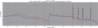

I now picking up pan-euro spot on two transponders{11108 V and 11185 V}with 1.1m dish on Astra 1N.Both have 13.6 dB!
Maybe can help you to make comparison between the two spots on both satellites-Astra 1N & 2F:
we shouldn't mix the different positions. Otherwise it gets too confusing ;)
..but here you are. Both transponders on 28E carry ACM signals.
btw. this is taken from my 75cm multifeed fixed dish :)

No. If I hit on the vertical peak I just get noise in the constellation window.
try again changing the frequency in small steps (1MHz)

You're right.let's do not mix the two positions.I posted signal from Astra 1 for Huevos if I understood well what he wanted.
I made a last scan on Astra 2F and unfortunately at this time I haven't managed to catch more transponders than those already known.

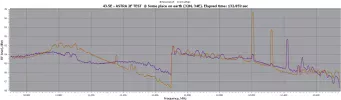

how add 5 transponder activ 12591v pe beam

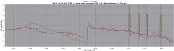

now 11357v 2gb
and 12422 litel down signal

A closer look showed that there could be 2 carriers. A vertical as well as a horizontal! I get a stronger vertical signal but horizontal also yields a very weak constellation diagram.
Here's my theory ;) The carriers are sent on different beams. V must be PE and H -> spot. beam. Outside of the spot footprint you will only see the vertical signal and right in the center the horizontal signal is even stronger than the vertical carrier. Apparently I'm a little off bullseye ;)
For proof more reports from users with the right gear (crazyscan, bigger dish) located in the spot beam area are needed.
