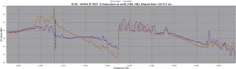

12208h strong pe beam
it peak signnal 5 secend down

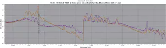

Solly, also tests on 10754V again. Very weak.
6,623
3,831
i not see any signal 10754v
even spectrum maybe too weak ?

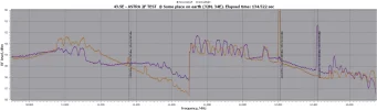

11121v spot beam

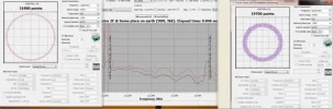

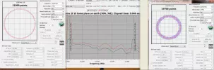

3 signal same time
12208v pe beam 12422h pe beam 11360v spot beam
3 signal same time
Can see 12207V @ +20dB. Absolutely nothing from 11360V. Are you sure that is not Africa beam?

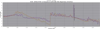

Your assumption about the beams are pure guesswork. It is impossible to tell which beam from just one position. I'm in the footprint of both beams and I can tell you that 11360V is just transmitting with low power.

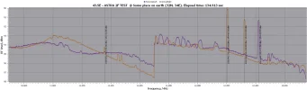

now 4 transponder activ
12208v,12325v,12422h,11360v

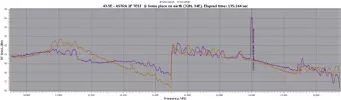

@Satesco, if you compare your screenshot with mine, I'd say that 12421H is the spot beam ;)

BlindFaith
Oct 2, 2011
639
309
TBS 5925
I don't think so.
Nothing to do with thinking or guessing.. ..my screenshot shows 12421H is a little stronger than 12207V whereas @Satecos's image shows a much weaker signal on 12421H. I'm in the footprint of the spot, he isn't.
