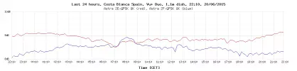

Pattern pretty regular now. Blue line is UK QPSK spot transponders between 10964 and 11127, inc.
