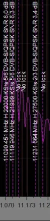

2,393
3,408
Continuous stream, so the video & audio it contains not visible or audible.
Thanks, do these look like copies of 11.009V and 11.186V?
2,393
3,408
Yes indeed they do, continuous stream and same symbolrate, but being ACM/VCM, other parameters changing all the time of course.

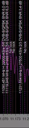

vladan10
Nov 24, 2012
76
bigger dish that you can think .
pc card
Southern Europe,Crete
crete greece
5m dish
sow strange
every 4 days we got signals on 2G pan europe (i think)
the screen is from today , next signals from this tps after 4days , 2D it was beter than 2G here :)
