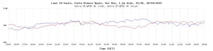

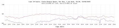

Ok, but surely they are going to have the data correct on their own transponder, right? This is data from DVB tables on 11223/11263H.
11126 V 22000 5/6 TSID: 2068
11223 H 27500 2/3 TSID: 2311
11225 V 27500 2/3 TSID: 2106
11263 H 27500 2/3 TSID: 2301
11265 V 27500 2/3 TSID: 2108
11307 V 27500 2/3 TSID: 2314
11343 V 27500 2/3 TSID: 2304
11344 H 27500 2/3 TSID: 2313
I honestly think they have just got the wrong data/not updated. Why would people in the south east of Europe (eg Greece) be reporting a loss of these transponders and gains in the north east (eg Finland) if they hadn't moved? Seems too much of a coincidence to happen just as other transponders where moved to 2G.
UK spot beams compared to 6 weeks ago.

I accept that the pattern is very similar to last year on 2E, worst time of year for our / my area. However, that 7 till 10 drop could cause a few problems for Emmerdale, Eastenders and Corrie fans!

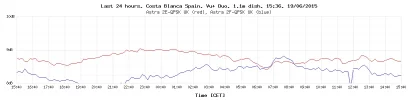

What happened to sky sports f1 hd sd seems ok ???????/
