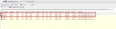

with much surprise today i found this tp
in dual feed and with lnb for linear signals
at the moment for the circulars I have not installed a lnb for extended C
180 laminas
3,934
6,021
180 laminas
No signal seen here as indicated from 13West on your analyser in Central UK with a dedicated 2.2mtr Extended Cband rig i'm afraid
But can see the signal from 40.5West Extended C-band for that channel

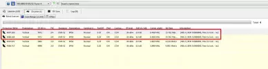

lnb solido quello a destra
Satellite 40 ovest
wrong meter info
the meter reads the broadcaster info
