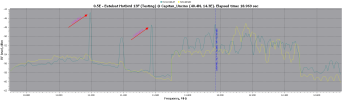

There are two test carriers at 0,5°E. Frequencies 11194,35 H and 11575,01 H.
11194,35 H.
11575,01 H
6,623
3,831
hotbird 13f test spectrum 13b
