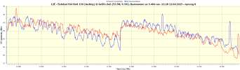

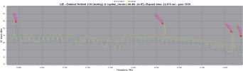

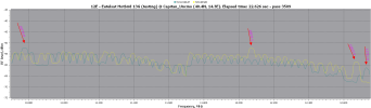

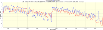

It is very difficult to observe the HotBird 13G test located in close proximity with a satellite filled with transponders over the entire range :(
