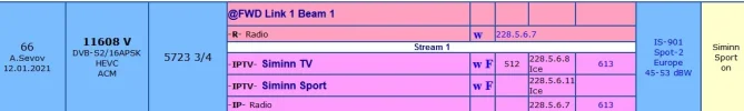

Maybe. Who knows? Maybe it has something to do with the start of Siminn TV broadcastin on 11608V. Maybe power management?
Siminn tv? Siminn is there since at least a year or two. i dont believe that this is somehting to do with siminn... the only thing that comes and goes is Simmin Sport that ive reported it to flysat (that A.Sevov is me). They (Intelsat) have maybe slightly shifted the beam towards to atlantic or just have reduced the power of the beam...

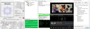

I didn't say in the previous answer,but it's good to know that 11609 V, 4374, 3/5 is the carrier of an IPTV stream(FTA) from Island.It has two streams,one tv and one radio.Fortunately it is still active and can be seen in real time,smoothly,as if you were watching on TV,provided that the signal to be strong.
To see and hear these streams you need a dvb card,TSReader app,VLC or Daum players.
A new old news,IPTV-over-Sat RiminnRadio streams are active,and not as reported on FlySat.
Checked 11609 V,5723,2/3,8PSK and both streams are working,despite the weaker signal in my area.
