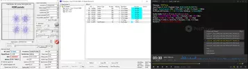

FlySat changed the parameters today after my report,but kept the previous information,for reasons known only to them.That's why I also came back to this iptv-over-sat streams,so that those interested know that it exists.
On this occasion I also discovered more radio streams on 228.5.6.7, which I thought it was good to know.
For intervening on the topic,I'm "punishing" you :) for listening to them.
I wrote to flysat and they have added some information back to page. they also explained me that they have upgraded something on webside and that upgrade brought some limitations (like adding IP numbers)
Satesco, you are older than me and highly experienced. I do follow you on other forums and appreciate your knowledge, thanks for all information you share with us.. im kinda carefull to call myself as DX:er but yes we do DX ing. We are trying to catch those weak signals and see what they have inside .. I love SDR, satellites and everything about radio communication.
On hardware side, i have a couple of TBS cards, a couple of SDR hardware and software on both Linux and Windows and on Mac, some LNBs, converters, LNAs, antennas for couple of different bands, RPIs, and many many more....
But things that i use most are TBS 6983, Adalm Pluto, Bullseye 10 kHz LNB, and a lot of software.
For those narrow low SR signals i do use my NooElec SDR E4000 Tuner or Adalm Pluto or my SDRPlay (because of the frequency range that these tuners can cover) + Dc-injector, DC passthrough or something similar to power up LNB ( i use my tbs card to power up the LNB and for controling frequency and polarization)
i forward the stream from sdr hardware to a DVB-S demulator and tunneling from demulator to TSReader or to similar software (depends on your setup and operative system on your computer)
But the easiest easiest easiest way is DVB-S2 Demod GUI from SWL-markro92 at AMSAT forum + NooElec e4000 + TSReader via TCP

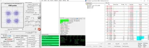

On a waterfall display you can easily see the bandwidth and guess the SymbolRate
First screenshot is the signal level for 11609 V with 65cm antenna with Bullseye 10 kHz LNB on it
Second screenshot is the frequency 11686,100 V - SR 83, which i havent reported to flysat. An audio stream encoded in ACC ADTS here is the sample
Satesco, please never stop to share your findings with us and thank you for everything

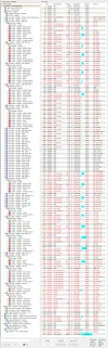

11597 V,500,8/9,S2-Q Radio (listen). Same package as on 11689 V. What do you say, Adam792?
2,181
3,160
11609 V,6532,3/4,16APSK-new symbol rate, but the same IPTV streams are there.
11689 V,166,8/9,radio,is not new (Hi FC GD :Y),but I was glad I could lock it.

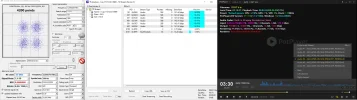

@FC GD,please check 11689 V,166,8/9 if there are more radio streams reported on FlySat. I can't do that because of the fluctuating signal. Thanks :)
11609 V,6532,3/4,8PSK-All three IPTV streams are working again, third (228.5.6.11) from the Premier League.
10989 V,1800,1/4, S2 pop-up as new transponder activated, and 11583 V with new symbol rate.

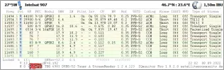

A successful lock, thanks to perfect atmospheric conditions and propagation.
11686.10 V
DVB-S2/QPSK​
83 8/9​
-NEW-
-R- Newstalk Ireland101 Engnew
Thanks for the info and congratulations on your success :Y
I confirm the presence of this transponder with a low symbol rate, obtained only with the IQmonitor app. Crazyscan does not know symbol rates below 100 Ks.
There are other transponders in this area with these low symbol rates, confirming what you found before and reported on FlySat.

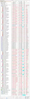

After modifying the FW, EDISION is ready for experiments with DVB-IP :-clap
27W_11607_72V_signal.jpg27W_11607_72V_prog.jpg27W_11609_72V_PIDs.png27W_11609_72V_NIT.png27W_11609_72V_DATA.png
0cfddab4:0201:052e
    s 11609720:6533300:1:0:-275:2:0:1:0:3:2
0001:0cfddab4:0201:052e:1:0:0
DVB-IP 11609.72 V Siminn Radiomidun
p:,c:031ffe

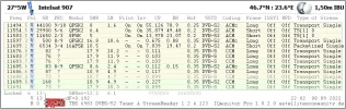

Signal level on my 65cm parabol has dropped drastically. What about you guys? According to another topic on OpenPLI there are many experiencing the same
2,181
3,160
HI, FC GD,
I noticed this last month when I tried to see the signal on some muxes. The weakest was 11495 V, around 6.0dB, in the afternoon. But I waited until the evening, when in my area, it increased, and I saw a slight improvement, about 1 dB, but not stable.
I monitored the satellite for a few days, and only those at the bottom of the band had an improved signal; then, gradually, it was a little better at 11495 V.
Unfortunately, on 11609V, which had the strongest signal at 27.1W before, with ip-over-sat, the signal weakened a lot. At one point, I managed to get a good signal on all muxes.
At one point, I also managed to make a Radio recording at 11689 V,166, having this time, as never before, a stable signal around 7.5dB, obtained with an Inverto PLL lnb.
However, the weakest signal remains 11495 V.
I remind you that I use a 1.50m antenna and IBU lnb:
