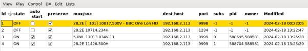

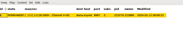

The next version of neumoDVB will allow streaming. Below you see a stream viewed on another computer
using mpv rtp://@:9997
vlc seems to have some trouble decoding the stream but mpv handles it perfectly.
Streams can be started permanently, which means neumoDVB will remember them and restart them each
time neumoDVB starts. They can also be manually turned on or off. For encrypted streams the stream
will be sent in encrypted format. This is probably not what you want, but that is the way it is.
Streaming is done using tsduck, and so that means that some services can be viewed properly in neumoDVB
but not streamed. T2mi streams also do not work yet.

neumodvb-1.6 has just been released. Apart from bugfixes for the above problems, the main novelty
is streaming, which is documented here:
neumodvb/docs/streaming.md at master · deeptho/neumodvb
Streams can be created for services or for full muxes. They can be configured to be permanent, in which
case they restart each time neumodvb is started.
Streams can also be used in combination with other software to examine the streams in detail, to view them,
to modify them, to play DAB radio....
This is documented here:
neumodvb/docs/external.md at master · deeptho/neumodvb
