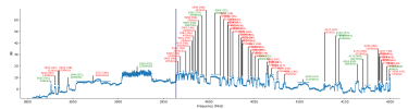

@deeptho, Thanks for fixing 22.0W for C-band :Y

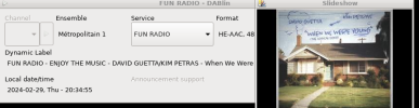

Using the 6909x card for the DAB Metropolitain stream on 11461 H,5780,3/4 at 5.0W with the neumoDVB stream, does not yield any result.
Something is wrong, and I would like to know because with tune-s2 and dvbstream the 6909x card works fine for this DAB.
When you have time for testing, I would ask you to try this card on this DAB French.
Instead, the 6983 card can stream DAB Metropolitain and works fine but with the command highlighted in the screenshot.
This just works here for the non-dab streams. That means any error is due to the external software being used.
deeptho
Apr 7, 2006
768
465
Europe
And dablin_gtk also works
tsp -I ip 9999 | fedi2eti 301 239.0.1.11 5001 | dablin_gtk
You need to stream the full mux as the pid is not referenced in a service

Your last reply about the French DAB command line on 11461 H has reassured me that I was not wrong using it, for which I thank you
But I don't know if you succeeded stream DAB with the 6909x card, although indirectly you seem to have answered that you succeeded on this mux.
If so, then I will try again.
Kind regards.
deeptho
Apr 7, 2006
768
465
Europe
Kind regards.
Yes. It simply works.

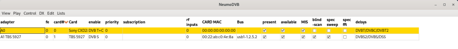

@deeptho
DVB-T scan failing after version1.6. The bug was mentioned in v1.5, but no fix shown in v1.6 changes.
I don't think it's my problem, as w_scan finds all channels in all available muxes from my TX.
neumo log mentions a couple of errors, but goes on to scan and lock 474MHz if I'm reading it correctly.
  • neumo.zip
deeptho
Apr 7, 2006
768
465
Europe
@deeptho
Llew, what do you mean by "the bug was mentioned in v1.5"?
Can you try the latest master? It may be fixed but I cannot test dvb-t
