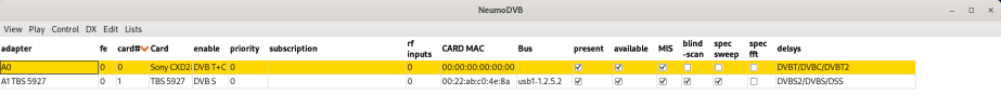

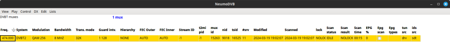

Bug: Scanning DVB-Cand DVB-T muxes fails.
Your latest push in Github neumoDVB fails to fix DVB-T mux scanning (at least for me).
PCTV DVB-T/T2 dongle in Raspberry.
Same in updateDVB scans OK so not a signal issue.

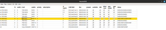

TBS6522 in PC (Fedora or Ubuntu) has same problem with the DVB-T scanning.
Same tuner in Crazyscan scanning OK.

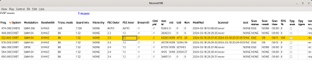

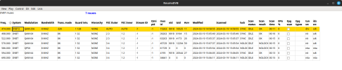

Some success, at least with the Raspberry.
PC with TBS6522 to do.
16,259
4,217
Doesn't lock on the PC with TBS6522. Only with the PCTV DVBT/T2 USB stick (Sony CXD2820R, as in the RPi).
Uncertain whether the neumo log will be of any help, as scanning on the PC (Fedora, also with Ubuntu) has shown to work OK with the PCTV stick.

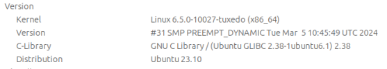

Good morning,
today I noticed that following appears in the terminal when I open the program:
Cannot load libcuda.so.1
I have obviously not yet managed to install the drivers for the TBS 6909X, as the frontends list is still empty.
16,259
4,217
Ignore. According to deeptho, cuda isn't necessary to run neumoDVB.
media_build using deeptho's installation instructions normally finds the drivers for TBS cards :-
