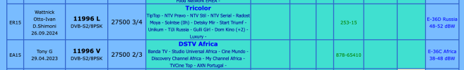

The only thing I can think if that you are getting remnants of linear signals from South Africa DSTV beam. A while back, I was able to lock 12054H transponder from DSTV. I don't know about now as I have neighbour's trees in the line of sight to big parts of the east and 36E is in the middle of these bushes.
It could well be that ? ... i will try skewing the l.n.b on those frequencies later ... that should maybe reduce or eliminate any linear .. whilst retaining most of the circular signal ?

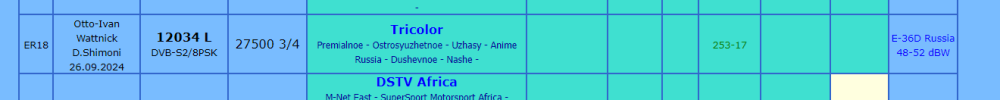

Just seen your post CJ , i cant see any reference anywhere , Lyngsat / Flysat, that shows Africa beams on those three problem frequencies - am i looking in the wrong place
**Correction - i can see 12.054 H is on the Africa beam
There's frequency reuse on all of the problem frequencies according to both Lyngsat and Flysat.

Thanks folks ... I guess frequency share disruption " is" the most likely cause .. i will continue to experiment - as and when i get the time ... other things take priority for most of the day today.
regards ...
