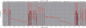

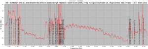

Blind Scan of 36 E with GT Media V7 from 2.4 C.M offset - North West UK. 13 transponders found.
Cant check on K/U Circular at the moment ... need to change the feedhorn for that ..
The only circular i was able to lock last time i tried it here was 12149 H 27500 ... its currently showing 7.5 db on the F15 receiver .. so in theory its less than 1.0 db below lock without a dielectric plate in the feed. so i,m sure i will still lock it with a plate in. .... i will try circular again when i get some spare time.
