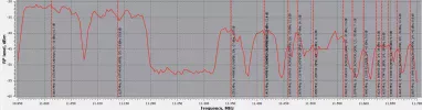

Here are the muxes you find at 15.0W, including the two with symbol rates of 107140.

I don't see those muxes satesco. I get 10979V and 11036V, and an adjacent one not locked at ~ 11136V.

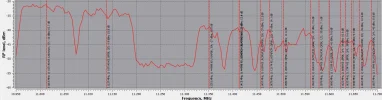

I checked the two muxes (11013 V and 11137 V) at 15.0W; as you can see in the screenshot, both have the same symbol rate-107140. Look at the time and date on my Crazyscan.
I think the errors you have on the spectrum may be due to the card you are using, probably 6903. I think that's why the errors on your spectrum are occurring.
But..., it's not excluded that they're coming from another beam(T12V North Sea 56), which doesn't cover my area.
Because these transponders have this high symbol rate, they can only be locked with the 6903x/6909x card, which has the stid135 demod.
(Strangely, FlySat deleted my report on these two transponders, because other users failed to catch and lock them. It happens this often, such as false reception reports)

Checked with TBS 6903X.
I can now detect the parameters of 11138V. The transponders 10979V and 11036V are almost certain to be on a beam such as North Sea 56 as you suggest.
So perhaps your TP's are on one of the MED beams, as if they are on the Europe and Middle East beam, 11013V would clash with the North Sea beam I am supposedly receiving?

10.95-11.2 GHz Ku-low band (EUME)
112.5 MHz bandwidth transponders
TP-1 11014V North Sea beam (S1)
TP-3 11014V Med Central beam (S3)
TP-5 11014V MidEast North beam (S5)
TP-2 11138V Med West beam (S2)
TP-4 11138V Med East beam (S4)
TP-6 11138V MidEast South beam (S6)
TP-23 11264H NorthSea beam (S1)
54 MHz bandwidth transponders
TP-61 10983V Europe beam
TP-62 11054V Europe beam
TP-63 11107V Europe beam
TP-64 11169V Europe beam
