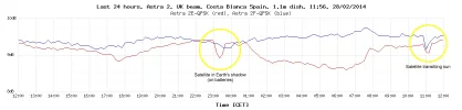

2E. How could I align to 2E using a 2F transponder?
Yes. Quite a bit. Look at the attached graph.View attachment 62493
If that happens, realign.
Oops, missed the bit about you aligning to 2E! Cheers for chart - does seem well worth pointing at 28.35. Unfortunately, realigning is a bit of a pain so might wait for Eurobird to disappear to the graveyard orbit as this might open space for 2E and 2F to move to their permanent positions. 28.4 or so for all satellites would seem logical to avoid interference from BADR.

Didn't know the switch to batteries also comes with reduced power, in this case for Astra 2E.
Do you think reduced power in the earth's shadow is also the rule for other satellites, ore more an exception?
2D used to do this so much that I couldn't receive it.
This is just the start of the satellite disappearing into the Earth's shadow. Continues until April 12th. Longest time in the shadow happens on 21st March where the satellite is on batteries for 70 minutes. According to the graph 2F doesn't seem affected. But we'll see over the coming days as the duration of the event gets longer.
Solar transit effects, on the other hand, are centred on the 5th of March and affect all geostationary satellites.

If a new satellite like 2E already reduces power in the shadow, looks like the batteries are not dimensioned for full power in the first place (to save space & weight).
About the sun transit on th Clarke belt, yes for you on 38ºN it's centered on 5 March, here on 52ºN it's tomorrow 1 March already!

Huevos, according to SES both 2E and 2F have the same construction, so why does 2E drop off so much at 22:25ish compared to 2F, do not blame you, blame SES

Perhaps 2E has not had sufficient solar charge to keep signal equal in "night mode" ie when away from the sun, just a thought.
