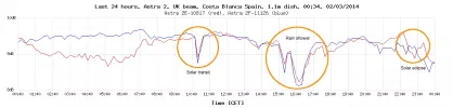

Dish must be too small if it went offline, here it is just a bump on the signal graph. but no loss of channels.
With a small dish on the fringes I have always suffered solar outages for a few days twice a year(spring/autumn), whilst my dish could be bigger it has worked perfectly in good weather for the channels I want except during these events.
I thought this was normal as when 1n was in situ my setup suffered solar outages for a few minutes and always around the same times. My dish size is limited by my budget .
Doesn't matter how big the dish is. Once the satellite is in front of the solar disc there is an increase in noise in the region of 10dB. To overcome that you would need an SNR in the region of 18dB to start with.

Yup dish size does nothing - I have a 2.4M here in Valencia - much bigger then needed and gives 100% SS and 100% SQ on my Humax Foxsat HD - yet I too get the solar outages twice a year. For a few days in succession they totally wipe the signal for about 2-4 minutes then all returns to normal again.
I actually look forward to the outages as it gives me a change to inspect the dish alignment using the focus of the LNB in the dead centre of the dish and I can see at once if there is anything getting in the way of the signal by looking for any shadows on the dish!!!

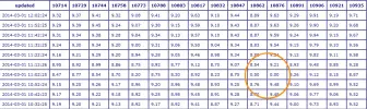

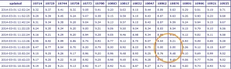

It's been up there 5 months. I'm sure that long enough to top up the batteries.
I would agree, but when in transit from 43 to 28 do they keep the solar reflectors open or closed? If closed, during transit could batteries have been slightly depleted and need a few extra days, or weeks , to reach full power for "sun down" transmission
Once the the solar array is open it is like that for the duration. Same with the antennas.
Also these batteries don't take weeks to charge. They need to be charged and ready for the next cycle in less that 24 hours. And right now there are about 30 transponders in operation so demand is over 3kW just to run the PAs.
But let's put this in perspective. Even a light rain shower has a much worse affect on signal than operation on batteries.

Love the chart Huevos re rain fall affecting signal. Some time ago I saw some calculations of just how much microwave energy gets absorbed by rain. Can't rememer all the details but they clearly showed how when the microwaves meet the rain water how much engergy gets converted to heat and so is lost to us for viewing - pretty dramatic I recall - and it made me marvel at the fact that with so much water already naturally in the atmosphere mopping up the microwaves even on a "dry" day, enough of that tiny amount of energy still gets though to us on the ground to resolve a signal! - I wish I could find the article again!

I was watching the Andrew Marr show this morning and lost reception just as the Kaiser Chiefs starting playing at the end of the show just before 11.00. I thought it was another shower but when I looked out the window is wasn't raining so I guess it might have been a solar outage judging by the graph above, as I get BBC1 on 10818 and this is the most shower-proof channel.
