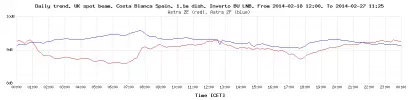

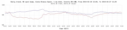

Not sure if it is my dodgy dish alignment or not but I aligned on a 2E transponder but many of the 2F transponders are stronger. Somewhat hoping it is the slight differences in footprints on the fringe or I might have to have another go.:-lol
2E is weaker most of the day. It's as simple as that. In that area you should get all the transponders most of the day except 10847, 10862, and 10936, which probably won't work at all. Just tried on my 90cm dish here (where signal is a bit weaker than your location) and I am getting all SD transponders except 10729 and 10758. And no HD transponders.
In that area, for a customer on a tight budget, I'd fit a 1.1m dish and be confident they would be happy with it.
