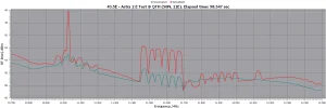

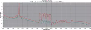

still 11.030V very strong here, no other 2E signals visible.
You may also get 12493 both at H and V polarities, very low here (reported earlier by a user from Italy, but I can't find his post right now)

if there is something, it's brutally weak:
