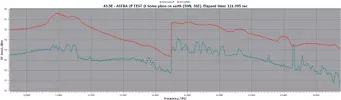

NAREK_ASTRALOVER said:
V; 12460H. Thus, it can be assumed that ASTRA 2F is capable of transmitting signal in this bands:
11700-12100MHz (Band E)
12100-12500MHz (Band F)
It seems that SES is considering transmitting signal even in 12500-12750 Mhz.band!A frequency has been activated at 12,591 V.I found it this morning:
ps_I'm not sure but I think it's signal at 12518 H , 12539 H.In my area the signal is weak in these frequencies.

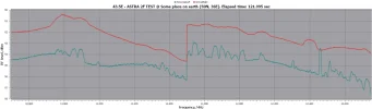

This is what I get now, a signal at 12590V, and maybe there is a weak signal at 12518V
