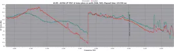

I'm receiving it now
6,623
3,832
it weak signal 12200h also me
can be spot beam

I can't lock it,the signal is gone
It was like all astra 2F signals with different power
6,623
3,832
change alot of singal low band and high band
10964 12200-12250

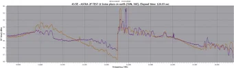

signal back with two transponder
11776h
11725v
11776h
11725v
These look like to be coming from the Türksat...
You can see two peaks at 11776h and that's where the Türksat has a divided transponder.
