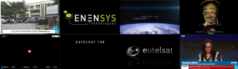

13.0E_11353 V,27500,3/4,8PSK-Eutelsat demo DVB-IP/MPE
  • 13.0E_11353 V_stream MPE_pids 10,11,12,13,14,15,16,17,18,19_2023-11-25_21-36-00.png

the 11317V and 11355V both have a strong signal but nothing to watch...
EnoSat
May 29, 2004
826
772
enosat.euweb.cz
Slovakia
For 11317V,11355V,12207H you need to have some knowledge of how to process TS :ph34r:
There are more options in Linux than in Windows (almost none)
rodscha
Sep 7, 2010
1,548
441
Thank you,so how do I process a TS? like a multistream,or different?
Then the listed channels are already FTA on other TPs,well except Museum and Zen tv...
,why would they scramble them there?
