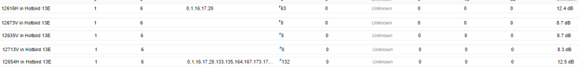

Absolutely nothing here at this time from any of them. Obviously STB isn't an accurate way of recording but I can get the spectrum analyser out with similar results.
1m dish with 13e as centre and 19e offset, 19e at 16dB mostly.

Reports (few) at 13.0E are made only with receivers.
It may seem useless, but it is good to know if users in Bulgaria would try finding and locking the signal with dvb cards.
And yet, because we don't have more reports, I would search on Bulgarian forums if the problem reported by @iandoh is true or not. I found on one of these forums, DXing.org(#541), an image showing that trp 12654 H was received, posted on 2.03.2024.
Whether it's true or not, users from Bulgaria looking for an answer on this English forum should look at those from their country.
