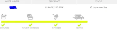

Hmm 3 days and no progress ? Btw there are some very positive but also very awful reviews on trustpilot

Despatched mine very quickly, think the only hold up was customs in the UK.
Mine was shipped the same day but no progress still showing, was it the same with you ?
No, I got tracking info for a few days, then no further updates until it was delivered.
Bear in mind the tracking info was useless anyway though.
