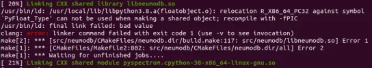

Hi deeptho,
I started installing your Blindscan for my dvb cards on Ubuntu 20.04. The kernel used is 5.13.0-35-generic. Installing it didn't pose any problems, so it recognized all my cards, as you can see from the picture below.
Unfortunately, there is a problem with Neumodvb. Each time, after using different versions of Cmake, the result is the same, i.e., it gives errors(2). I tried to solve this problem, but I don't see what is causing the errors. Maybe you can determine the cause of these errors in my screenshot.
Thanks in advance :)

Satesco,
you probably link against the wrong library. Perhaps the python library is the problem. That is what the message says.
You link with statically with python (should be a dyamic link: .so instead of .a) and the python version is 3.8 (perhaps not a problem, but mine is 3.9).
Did you change any of the cmake settings? Did you install all prerequisites? Specifically python3-libs?
Be also careful with mixing /us/rlib and /usr/local/lib. It could very well happen that you have some left over of an older python version
installed in /usr/local//lib. I do not know ubuntu well enough to know about its conventions, but on fedora this is exactly what
would go wrong if ever you compile your own python (will end up in /usr/local/lib) and then later install the official one (will end up in /usr/lib).
In general it is better to post the log files of the build (on github. Just rename them to .txt) than screenshots which disallow cut and paste.

@satesco
If it's any help, all I have in /usr/local/lib/python3.8 (not libpython3.8) is some dist-packages (histogram, scatter-intensity). For me, python3.8 resides in /usr/lib.
My full dist-packages folder is in /usr/lib/python3 (no version number)

2,147
3,074
It seems that the respective folders are installed correctly.
But you better see where the error comes from, reading the whole Neumodvb installation process in Cmake.log folder (in Attach..).
I also checked the driver for 6903x with the Kaffeine player. As you can see, everything is working fine. I'm waiting for a blindscan with Neumodvb. But before that, I must of course install it properly.
I am attaching some log files, which I hope will help @deeptho indicate the source of the errors that occur when installing neumodvb.
Thanks :)
Thanks :)
Might be your version of cmake (3.20?) - deeptho warned against using that version in the Install doc. Ubuntu usually offers 3.20 in their downloads.
I use 3.16.3. You could try a pre-3.20 from cmake's list -

@satesco
Linux Mint Cinnamon 20.2 kernel 5.9.0-rc7-tbs+
Well, the error message shows that the build loads something from there. So this is a local configuration error (probably).

I gave up Clang-10 for Clang - 11.Unfortunately with the same error 2. What exactly does this error generate? Who can tell me? Thanks.
Added:meanwhile deeptho releases a new version of Neumodvb. I'll try this one. Who knows, maybe I'll make it.
Added 1: Reading the news that brings the new version, I realize that the installation procedure of Neumodvb has not changed. So elsewhere I have to look for the solution ?!
  • neumodvb error 2.zip
