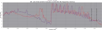

the screen signal over 2f pe beam
much weker here
maybe doring days will be litel more strong
like 1n or morning or night receiver signal here pe beam on 1n
about astra 1n it field panel solar why it ses plan to move astra 1n to 19.2e if field panel solar
only resons 2c soon end of life ?
