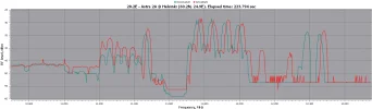

Update from Helsinki. You can easily figure out transponders I have lost. On Tuesday I had 210 FTA channels, today 135.
freq  AGC [dBm]      SNR [dB]
[MHz]    Oct-1    Oct-4    Oct-1    Oct-4
11221H    -39      -40         6.0         6.9
11223V    -35      -35         9.5         8.4
11259V    -34      -34       10.7       11.4
11260H    -39      -38        6.9         7.7
11306H    -39      -39        7.7         8.4
11306V    -36      -36        9.5         9.5
11344H    -40      -37        8.4       10.4
11344V    -36      -39       10.4        8.4
11388H    -40      -40        9.0        9.5
11390V    -38      -36        9.0      10.4
11426V    -41      -40         7.7        8.4
11427H    -42      -41         6.9        7.7
11469H    -36                   12.3
11488V    -36                   13.6
11507H    -37                   12.7
11526V    -36                   13.0
11545H    -38                   11.7
11565V    -38                   13.0
11584H    -37                   12.3
11603V    -38                   13.0
11622H    -41                   12.7
11661H    -39                   12.5
11681V    -34                   12.5
11719H    -35    -36           9.5       9.5
11739V    -36    -36           9.5       9.5
11758H    -27    -27         16.8     16.4
11778V    -28    -27         14.6     14.9
11797H    -35    -35          9.5       9.5
11817V    -36    -35          9.0       9.0
11836H    -28    -27        14.9     14.9
11856V    -28    -27        16.4     15.6
11875H    -37    -38          9.5       9.5
11895V    -37    -37          9.0       9.0
11914H    -29    -28       14.9      14.3
11934V    -29    -28       14.7      13.9
11953H    -36    -36        9.5        9.5
11973V    -37    -37         9.0       8.4
11992H    -29    -29      14.3      13.9
12012V    -28    -27      16.3      16.9
12031H    -38    -39       9.0        9.0
12051V    -38    -38       8.4        7.7
12129V    -38    -39       8.4        8.4
12285V    -40    -40       7.7        7.7
12343H    -41    -41       6.9        6.9
12382H    -31    -31     16.3      16.0
12460H    -34    -33    15.4      16.3
12480V    -32    -31     14.7      14.9
12523V    -40               10.4
12560V    -40               10.4
12560H    -44                 9.5
12607H    -46                  7.7
12607V    -40                10.4
12643V    -42                  9.9
12643H    -44                  8.4
