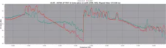

i got uk beam strong now on 2f
i never see 10964h so stronger
