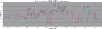

Here is a crazyscan Helsinki with a 110 cm dish and a transponder list from crazyscan's blindscan program.
As you can see no hope in UK spot beam or 1N Pan european 1 beam.
Flysat list 12129 V in 1N Pan Europe 1. Other PE1 I cant receive so it must be PE2 or 2A south beam (I bet this one). Flysat lists 12422 H and 12441 V 2A south beam, but can't receive them. It's possible they are 2A south, during the 2012 Olympics there were south beam transponders I could not receive (were they in 2B?) King of sat says 12441 V 2A south and 12402 V 2A north beam (flysat 1N PE1), which it can not be.
Thanks for posting this, I would be very grateful if you could do another similar scan next week once the new 2F transponders are active.
I remember installing a 1.3m dish in Helsinki several years ago and a couple of the 2A/2B southern beams really required some careful alignment and skew to get them. There was quite a wide difference between those south beams even on the same satellite. (Even more weird, when I installed a 90cm dish in Kuusamo I managed to get all southern 2A and 2B beams no problem!)

@miha20: it's interesting you get stronger levels for the 2F spot beam than the 1N spot beam ... proabably side lobe effects.
@huve: you only get a signal from the 11.008V GHz data transponder but none on the 11,181VGHz one? Interesting... so they are not the same beam.
